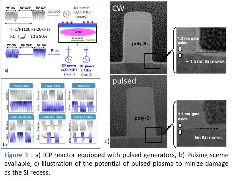

The two ICP reactors of the 300 mm etching platform are equipped with generators that allow short-pulse modulation of both the RF power injected into the plasma and the RF bias power applied to the substrate. The modulation of the two generators can be independent, synchronized, and more recently asynchronized (see Fig. 1a,b). This reactor evolution enables precise, quasi-independent, time-resolved control of all plasma parameters governing plasma–surface interactions: the ion flux and energy, and the chemical nature of the plasma species.
Over the past 20 years, the team has clearly demonstrated the potential of pulsed plasma technologies to improve process control at the nanometric scale and to minimize plasma-induced damage (see Fig. 1c) [1–9]. The study of the mechanisms involved in pulsed plasmas will continue in order to address ever more complex challenges associated with the miniaturization of CMOS devices at sub-5 nm technology nodes.

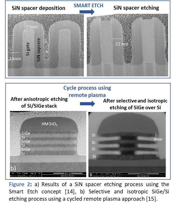

In recent years, the group has worked on a new etching concept, called Smart Etch [10], which consists of cycling light-ion implantation steps carried out using a capacitive plasma, with selective removal steps driven by neutrals produced in a remote plasma. This approach enables quasi “atomic layer by atomic layer” etching (quasi-ALE, for Atomic Layer Etching).
This concept has demonstrated its potential for performing selective anisotropic etching (for example, the etching of SiN spacers in a transistor gate, a process that selectively removes the horizontal surfaces of SiN relative to the vertical surfaces with nanometric precision, (Fig. 2a) [11–14], as well as selective isotropic etching (Fig. 2b) (for example, for the fabrication of horizontal Si nanowires in gate-all-around devices, where a two-step cycled process using only remote plasmas enabled the selective removal of SiGe with respect to Si) [15].
